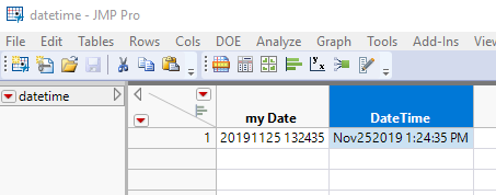

Attached is a data table with the conversion formula included.  Here is the formula being used
Date MDY(
	Num( Substr( :my Date, 5, 2 ) ),
	Num( Substr( :my Date, 7, 2 ) ),
	Num( Substr( :my Date, 1, 4 ) )
) + Num( Substr( :my Date, 10, 2 ) ) * 3600
+Num( Substr( :my Date, 12, 2 ) ) * 60
+Num( Substr( :my Date, 14, 2 ) )

THANK-YOU.  The formula works very well.
