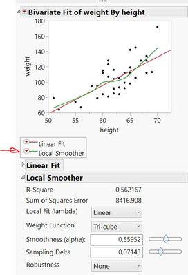

Using Big Class and Bivariate Fit of height by weight. You can use the kernel smoother and get a fit report as well a red hotspot next to the fit legend:bivariate.JPG

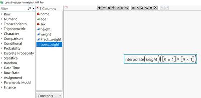

There you can save the coefficients (X Loess, Y Loess), as well as the prediction formula. The formula will be harder understand if you just look into the formula editor
, but double clicking in the formula will show you the full formula:
Interpolate(
	:height,
	[51, 55, 58, 60, 62, 64, 66, 68, 70],
	[66.4237610962498, 77.9887711985387, 87.676320121761, 99.4642495608787, 100.773120401001, 105.139185406223, 117.30361698686, 130.514041992402, 144.259907247776]
 The values used are the coefficients again. Based on your sampling Delta you may get more/less coefficients.
