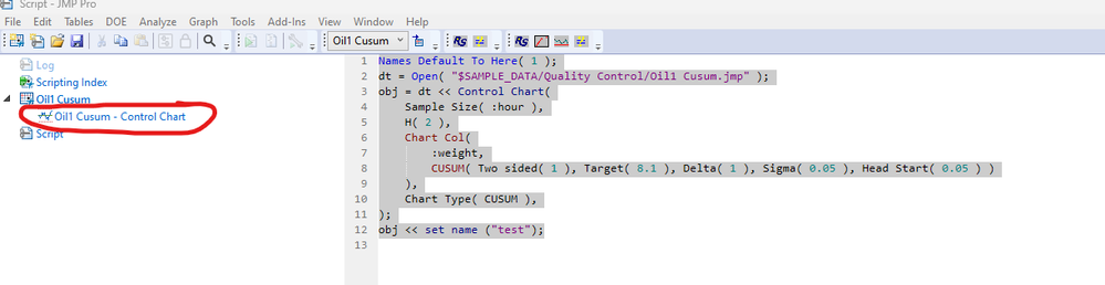

Can someone tell me how to change a CuSum chart name in JSL ?  in the below JSL example

The chart name defaults to Oil1 Cusum - Control Chart, as per screen shot below.  I would like to be able to change this in JSL, without having to do a "file, save as" and losing time writing the file to a drive.
I've tried  obj << set name ("test") ; and obj << set control chart name ("test"); to no avail. Any ideas?

You are trying to change the name of the window, so you can use << Set Window Title
Names Default To Here(1);
dt = Open("$SAMPLE_DATA/Quality Control/Oil1 Cusum.jmp");
obj = dt << Control Chart(
	Sample Size(:hour),
	H(2),
	Chart Col(
		:weight,
		CUSUM(Two sided(1), Target(8.1), Delta(1), Sigma(0.05), Head Start(0.05))
	Chart Type(CUSUM)
obj << Set Window Title("TEST");
-Jarmo

Re: CuSum chart name
worked perfectly, thank you
