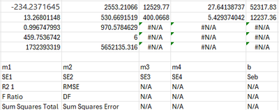

  If you do the same multiple regression in Excel, you get this for the output with the same input data as with JMP:
  The bottom portion of the screenshot shows how the data from the LINEST function is laid out when turning on the stats option in the function. If you look closely, you'll see that the estimates for the fit as well as the statistics are all identical to JMP. The only thing that shows up as being different is the rounding, but that's because JMP's default is set to a smaller number of significant digits than Excel.
  So to me, I'm not sure where you are seeing a discrepancy. I'd have to use your same data to see if I can reproduce the differences that you're seeing. With this data, I get the same from both software.
