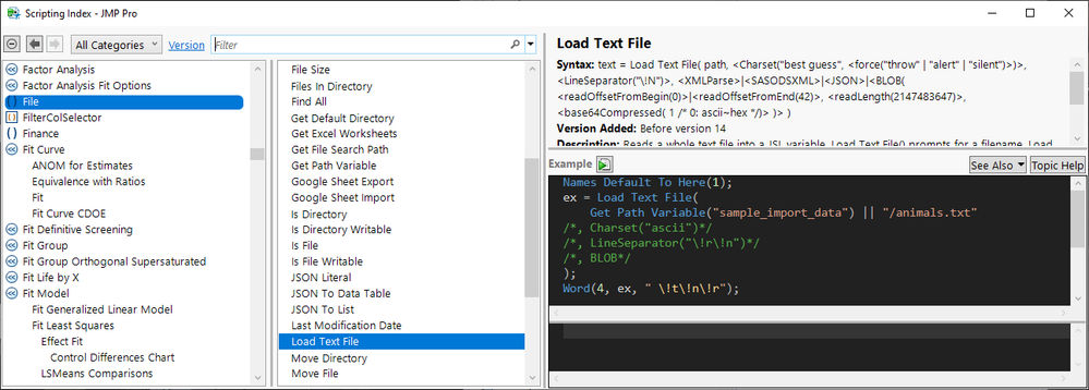

jthi
Re: How to read read from text file and load the data into Text Edit Box component?
I'm not sure where you are getting your functions from but those aren't JSL functions. Utilize Scripting Index with correct category (Character in this case) and check out what functions JMP does offer (most likely you are looking for Words())
https://www.jmp.com/support/help/en/17.2/#page/jmp/list-functions.shtml?os=win&source=application#ww...
-Jarmo

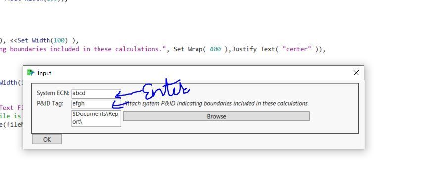

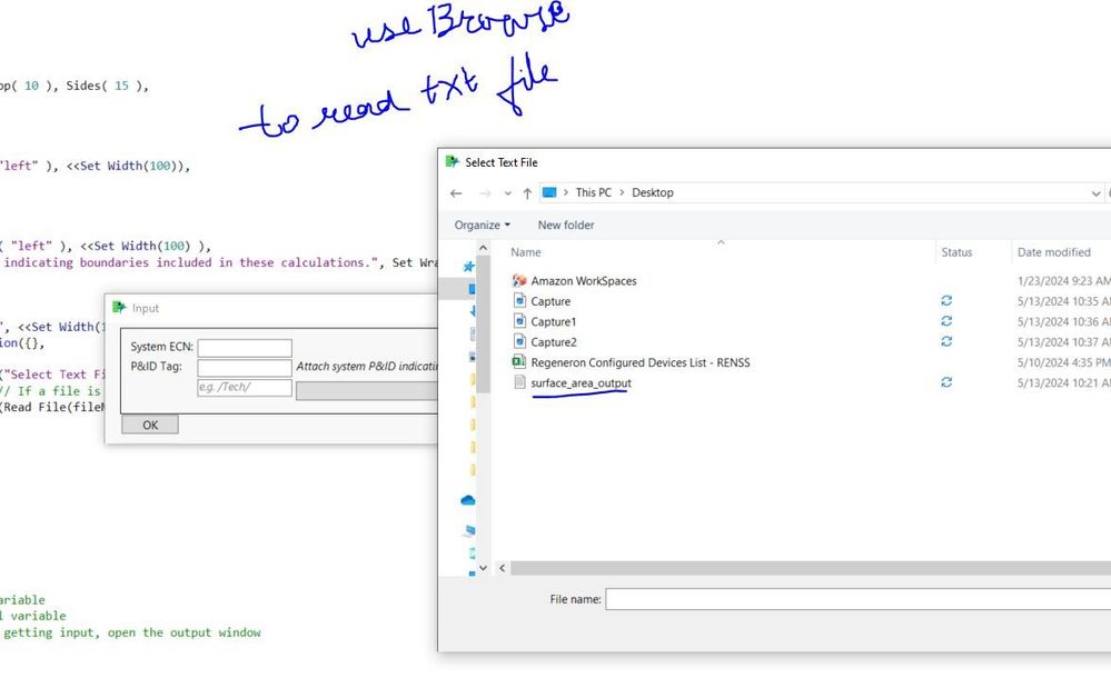

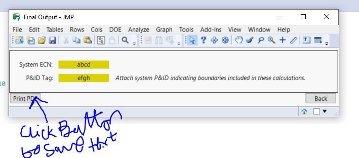

PunitPanjwani
Level II
Please see the attached photos.. Any help is much appreciated.
