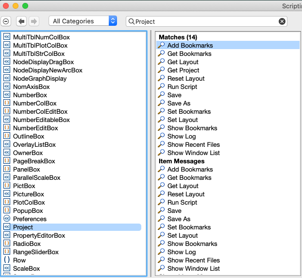

'Help > Scripting Index' gives some reason to be optimistic:
But, if it's new, I would build one by hand first to see how well it fits your use case.
I'm sure there is other 'how to' content in addition to the Discovery paper I quickly found, and the JMP Help and Books should get you a long way.

Sounds like you want to make a self-contained bundle of content that can somehow be made available to others. The 'best' way will depend very much on the details of the workflow and interface you envisage. You could consider using JMP Projects.

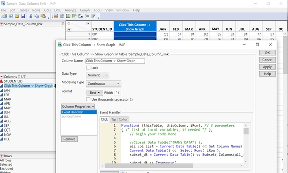

jongtae
Level II
Re: Create a Journal via JSL that connects a table to a large number of graphs
I added a column to the data table.
And The added column has an event added. The code below is the event handler example code.
