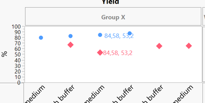

Hi,
I am a new user of JMP 14.
How can I add  to each data point its own value.
I have 2 columns (numerical) on y-axis and 1 column nominal on x-axis. Each point has one value.
I need to add Y values to the points.
Thanks a lot for help.
Re: How to add value label to points?
I should add one more thing. It looks like you might have your blue dots in one column and your red dots in a different column. That would cause the "double labeling" to appear.
If that is the case, STACK those two columns so that all of the percentage values appear in a single column. This will also add another column that will identify which value it is, either red or blue. Use that red/blue column as a color for the points. That will also have the benefit of giving you the single label for a point rather than two labels.

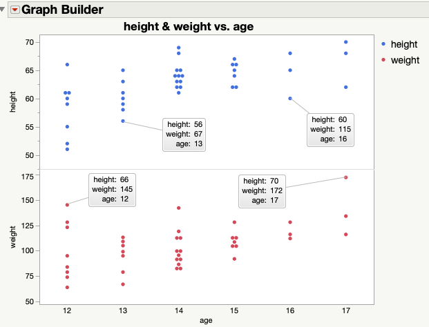

ian_jmp
Level X
The best way may depend on which JMP Platform you want to use, and if you choose to do it 'by hand' or programmatically via the scripting language, JSL
I would start by understanding how to label data by rows and columns, and also how hover labels work. Using this approach, you can quickly get, for instance:
This may or may not be exactly what you want.
Hi Ian,
Thank you for your reply. I have tried these suggestions before. Unfortunately, I did not manage to solve my issue. I would need next to blue dit only 84,58 and next to red square 53,2. So the real values of these dots. Do you maybe know how could I get this?
Make your Y variable a label column. When you click on the point, that value will appear. If you want the value to always be there, click the point and choose Rows > Label.
Look at the Label Rows and Columns section from JMP Help.
Dan Obermiller
Bojana
Level II
Hey Dan,
Thanks a lot. Stack and label color, helped me to get the graph as I needed.
BR
Bojana
