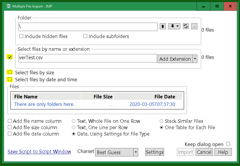

The syntax serves three purposes: remembering the full state of the dialog if you want to re-launch the dialog with pre-populated values, running the import, and showing the possibilities. The filters are an example of all of those:
	<<Set Name Filter( "verTest.csv" ),
	<<Set Name Enable( 1 ),
	<<Set Size Filter( {100, 100} ),
	<<Set Size Enable( 0 ),
	<<Set Date Filter( {3666002110.40841, 3666002110.40841} ),
	<<Set Date Enable( 0 ),
Comparing that to the dialog,
using <<CreateWindow instead of <<ImportDatausing <<CreateWindow instead of <<ImportData
there are check boxes in the dialog that enable and disable the filter. Above, the name filter is enabled and the size and date filters are not in use. The values in the size and date filters are either (1) the last values you experimented with, or (2) the size range and date range of the file you selected. Most likely (2). So your file is probably 100 bytes long. The number is a JMP date-time value, you can use something like asdate( 3666002110.40841 ) to get

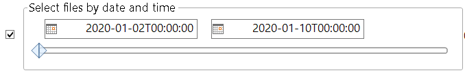

...and you can use dates like this
	<<Set Date Filter( {2jan2020, 10jan2020} ),
	<<Set Date Enable( 1 ),
<<CreateWindow with pre-populated date range<<CreateWindow with pre-populated date range
