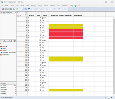

hcarr01
Level VI
Re: Color on indicators
Thanks for the reply, I'm trying to create a similar table with red, yellow and green indicators.
My goal is to create:
- if 5 consecutive points (or more) are red (above 3 sigma) so the color of the last point is red
- if 3 consecutive points (or more) are red (above 3 sigma) so the color of the last point is yellow
- otherwise green color
Attached you can find a table that serves as an example, I created the following script but without success:

txnelson
Re: Couleur sur des indicateurs
I remain confused.  However, given the data table you supplied, which appears to be a table that has the results of what you are attempting to calculate, one can easily color the cells for your Indicateur column
names default to here(1);
dt=current data table();
dt << New Column("Indicateur", Character, Nominal);
:indicateur << color cells("red",dt<<get rows where(:status=="red"));
:indicateur << color cells("yellow",dt<<get rows where(:status=="yellow"));
:indicateur << color cells("green",dt<<get rows where(:status=="green"));

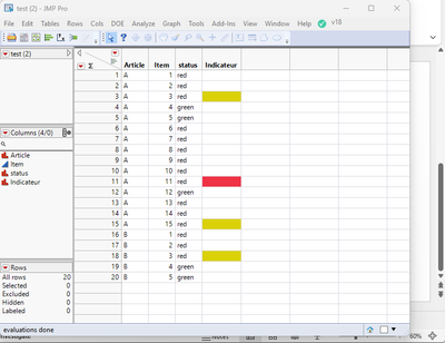

hcarr01
Level VI
Hello, thanks for the reply, it works well on this test base!
I'm trying to generalize this script when I have multiple articles. The color indicators are created per article.
I am using the following script but I am not getting the correct end result:
dt = current data table();
// Créez une nouvelle colonne pour l'indicateur
one_color = "xyz";
icolor = 0;
Summarize(dt, unique_objects = by(:Article));
m_obs = dt[0, "Article"];
For each( {unique_objects}, m_obs,
for (i = 1, i <= nrows(dt), i++,
	one_color = dt:status[i];
	if (one_color == "red",
		icolor++;
	// else
		if (icolor >= 5,
			dt:Indicateur << Color Cells( "Red", i-1 );
			icolor = 0;
		// else
			icolor >= 3,
			dt:Indicateur << Color Cells( "Yellow", i-1 );
			icolor = 0;
// Handle the last row
if (icolor >= 5,
// else
	icolor >= 3,
The result obtained:
undefined
Line 18 should have the yellow color because there are 3 consecutive red points for article B...

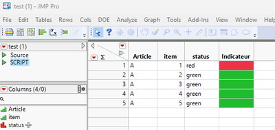

txnelson
Here is my approach
one_color = "xyz";
icolor = 0;
For Each Row(
	// If the value of Article has changed set icolor to 0
	If( Lag( :Article ) != :Article,
		icolor = 0
	// If status is red, increment icolor else set it back to zero
	If( :status == "red",
		icolor++,
		icolor = 0
	// Check for the number of icolor
	// Set the value for the cell to the appropriate color
	// When a color is specified remove no longer correct cell colors
	// for previous rows
	If(
		icolor >= 5,
			dt:Indicateur << color cells("red",row());
			dt:Indicateur << color cells("",row()-1);
			If( icolor == 5,
				dt:Indicateur << color cells("",row()-2);
		icolor >= 3,
			dt:Indicateur << color cells("yellow",row());
Jim
