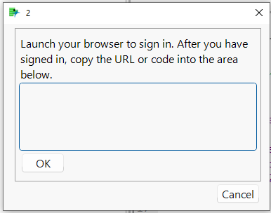

Security setting prevent me from getting credentials via the embedded browser.
So I tried
oauth2 = New OAuth2( Browser Type( "External" ) );
This way, the authentication works - but I don't get a"code" or "URL" which I could enter here:
