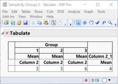

txnelson
Re: Weighted mean
To get what you want, I would calculate the values outside of Tabulate, and then just use Tabulate for the formatting.
Names Default To Here( 1 );
dt = New Table( "Sample",
	Add Rows( 4 ),
	New Column( "Group", Numeric, "Ordinal", Format( "Best", 12 ), Set Values( [1, 2, 3, 3] ) ),
	New Column( "Subgroup", Numeric, "Continuous", Format( "Best", 12 ), Set Values( [1, 1, 1, 2] ) ),
	New Column( "Column 2", Numeric, "Continuous", Format( "Best", 12 ), Set Values( [3, 3, 3, 9] ) )
dtSum1 =dt << Summary(
	Group( :Group ),
	Mean( :Column 2 ),
	Freq( "None" ),
	Weight( "None" ),
	statistics column name format( "column" ),
	Link to original data table( 0 )
dtSum2 = dtSum1 << Summary(
	Mean( :Column 2 ),
	Freq( "None" ),
	Weight( "None" ),
dtSum2:Column 2 << set name( "Column 2_1" );
dtSum1 << Concatenate( dtSum2, Append to First Table(0));
 dtSum1 << Tabulate(
	Show Control Panel( 0 ),
	Add Table(
		Column Table(
			Grouping Columns( :Group ),
			Statistics( Mean ),
			Analysis Columns( :Column 2 )
		Column Table( Analysis Columns( :Column 2_1 ), Statistics( Mean ) )
Jim
