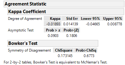

I agree with Dan the Fit Y by X Contingency analysis with the Mosaic plot and Kappa statistic provide more information. It is especially useful for more than 2 levels, and provides additional statstics.
As an FYI, if the two columns of 0s and 1s are continuous, use the multivariate platform and select the CI of Correlation, This is the Kappa statistic for this simple 2 level case.  Hopefully, this provides some insight into the Kappa statistic.
Multivariate Platform, Continuous Modeling TypeMultivariate Platform, Continuous Modeling Type
Fit Y by X Platform, Nominal Modeling TypeFit Y by X Platform, Nominal Modeling Type

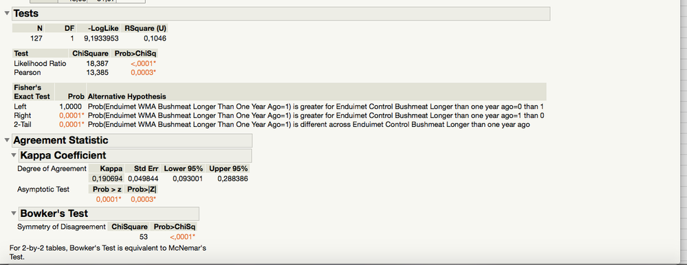

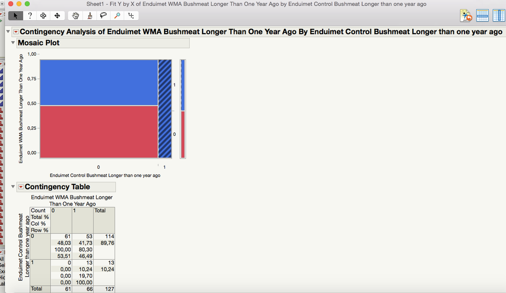

So I have done the Fit Y by X and looked at the agreement statistic and it looks like this:
I think there is an issue with total number of answers. In Column 1 there are 127 answers (0's and 1's) and in Column 2 there are 158 answers. However when doing the above analysis it only compares for 127 in total, as can be seen in the screenshot. Is there any way to bypass this, because I do not really see if there is any relevant information to be obtained from this as it is now (P-values look a little suspect).

Your follow-up question has me concerned.
For correlations (or the agreement statistic) you have observations that are matched. I thought that the inside measurement for row number 1 of your dataset was for person #1 (l will use the name "Fred"). "Fred" also provided the value in row number 1 for your outside measurement. One way to think about this is: Could I reorder all of the values in one column and still have the data make sense? If the answer is that reordering one columns would destroy the dataset validity, then the columns are matched. If the answer is that the reordering is fine, then the data are not matched and you have two independent samples.
If your samples ARE matched, then how did you end up with more observations for one column than the other?
If the samples are NOT matched, then the analysis advice that you have been given so far is not correct. You are looking to see if the two independent samples are different from each other. You will need to restructure you data table to perform that analysis, which will be equivalent to a two-sample proportion test which answers the question: is the proportion of 1's for population 1 different from the proportion of 1's for population 2?
Respond if you really have the two independent samples information. If you do, then the details can be given on how to structure your data and get that test.

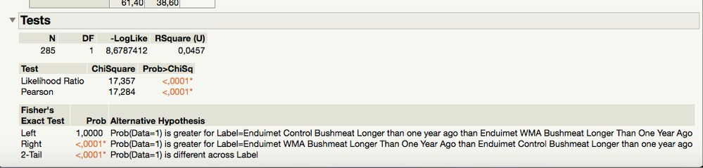

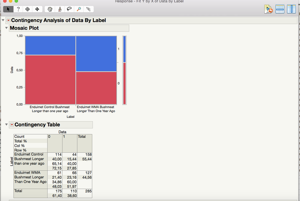

Alright, so I have done what you have explained here and this is what I get:
Skærmbillede 2018-08-16 kl. 20.16.09.pngSkærmbillede 2018-08-16 kl. 20.16.09.pngSkærmbillede 2018-08-16 kl. 20.16.43.pngSkærmbillede 2018-08-16 kl. 20.16.43.png
All of the data is now included, which is great, but I still think that the P-value looks very suspect? If this is right then there does not need to be much difference between the areas in order for the p-value to be very significant.
What are your thoughts on this?

Actually, based on your data in the picture, I would expect to have a low p-value. The low p-value says that the proportion of 1's is not the same for the two groups. The control group has 27.85% 1s. The other group has 51.97% 1s. That is a pretty sizable difference in my opinion (an increase of almost 25 percentage points). Especially with sample sizes in the 125 to 160 range. That large of a difference is probably not due to chance.
Look at the mosaic plot. The blue bar is representing the response of 1, and it is much larger for the one group. Just out of curiosity, how big of a difference did you think you would need to see for it to be declared statistically significant?
