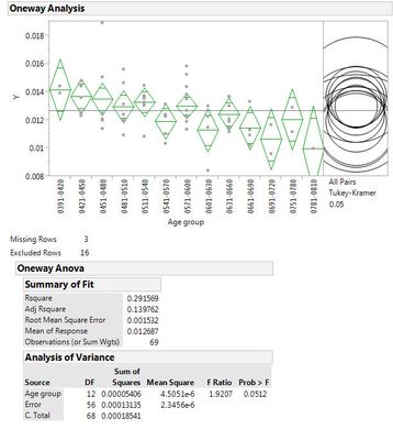

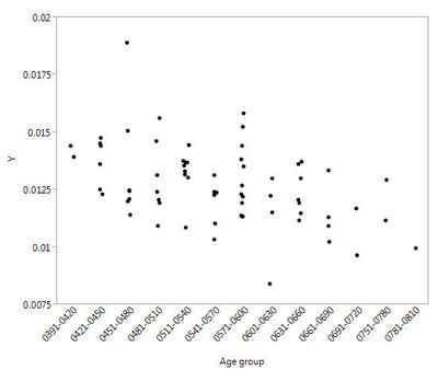

My ANOVA analysis indicates that there is no statistical difference between groups.  However, when I plot as a simple chart, there is obviously a downward trend to the data.  Which do I "believe"?
susan_walsh1
Staff (Retired)
Re: Significance of data?
The ANOVA is used to determine if there is a statistically significant difference between the means of the groups. In this case you can see that the means diamond for every group overlaps the overall mean of the data, so it is not surprising that a statistically significant difference is not found.
If you have the data to create a continous variable for age rather than a categorical variable, then a regression analysis would be done to test if the slope of the line is significantly different than zero. This would be the analysis you would need to identify a trend.

Hi, Jeff!
You are making a critical error when you say "My ANOVA analysis indicates that there is no statistical difference between groups."  Don't feel bad.  You are not alone.  There is a tempest swirling around significance testing in science now, specifically regarding p value thresholds.
The correct statement is along the lines of "My ANOVA analysis barely fails to reject the Null hypothesis."  It does not say "There is no difference"...there clearly IS a difference; you can see it.  There is not enough evidence to detect a significant difference given these data, although it is very close.
You should design the test to be powerful enough to statistically detect the difference about which you technically care.  If you care about the difference you see with your eyes in these data, believe that.  And next time, design a balanced test that provides adequate power to detect that difference a priori.
Hi Jeff,
Look at your connecting letters report and your LSD threshold matrix further down the page from what you are showing above.  From what I can see you have at least 4 groups that are significantly different than 0391-0420 based on the overlap or lack there of the mean diamonds at the at upper and lower overlap marks.  The R-square also indicates there is some difference in the different groups. If there was little difference the R-square would be closer to zero.
If there really is a downward trend, a regression model should be more effective for detecting it: Y versus a continuous variable such as individual age or group mean age.

Have you place a fitted line through the data with the 95% confidence band?  If the line can be moved within the band into the horizontal position, then the "trend" is not significant - this is often the case.  So-called "trend lines" are often abused.  You might also look at the "connecting letters report" - very useful.

Another thought:  A properly constructed Process Behavior Chart or even a Run Chart might show that you have a shift rather than a trend in the data.
