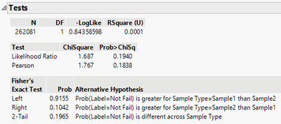

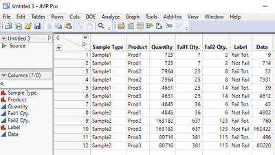

The trick here is formatting your data differently, which I did by adding one formula column, then stacking the data. Then, the Fit Y by X platform should work for you. I did make an assumption though, that what you were looking for was the difference in total failures by each sample type--if you meant to include Fail 1 Qty and Fail 2 Qty, then you'll need to approach differently.

Thanks for your answer! I also found the  "Two Sample Test for Proportion" and the "Analysis of Means for Proportions" to support my analysis once the fit Y by X was done. The data stacking was not so straight forward, thanks for mentioning how it should be organised.
