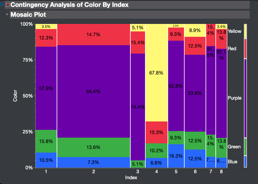

The settings I am talking about aren't affected by the Styles or Graphs preferences. I added pictures to be clearer.
  1. The Y axis on mosaics appears to always default to 2 decimals (0.25) and I don't see a way to get it to default to percentages (25%). It is a summary value, not reporting a column value, so there isn't a column format for JMP to use. (see before and after pix below; in the example below, the relevant column is text [Yellow...Blue], not numeric)
  2. By right-click>Customize>Mosaic I can set line width to 0, and vertical gap to 0. (see effects below) Any way to set that as a default?
  3. By right-click>Axis settings I can turn off Auto tick marks on the right and bottom axes. (see effects below) Any way to set that as a default?
BEFORE:
AFTER:
