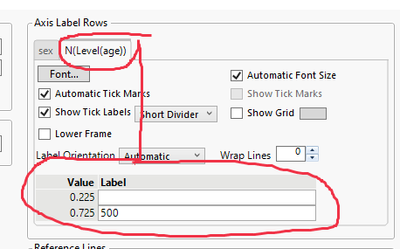

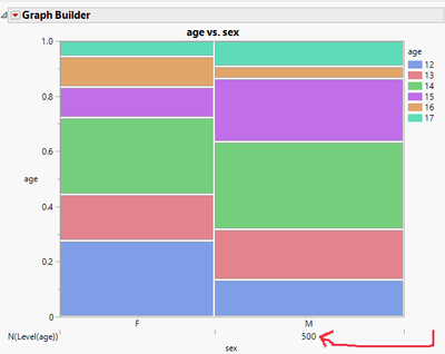

Yes, there's a way to put it below the chart area, assuming you have JMP 17, and assuming that you're working with the Graph Builder instead of the Fit Y by X Platform. The trick is to add a Caption Box, then set it to be an Axis Table, then overwrite the defaults by deleting all but one of the labels (also, I had to change the Tick Labels to "Short Divider" to make every label show up in a contingency table). This can be done via scripting as well; example below.

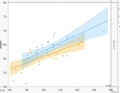

Not sure about question 1 but here is a script using << Add Graphic Script to add text to graph builders bottom right corner
Names Default To Here(1);
gb = dt << Graph Builder(
	Variables(X(:weight), Y(:height), Overlay(:sex)),
	Elements(Points(X, Y, Legend(9)), Line Of Fit(X, Y, Legend(11)))
Report(gb)[FrameBox(1)] << Add Graphics Script(
	included_rows = N Rows(dt) - N Items(dt << Get Excluded Rows());
	Text Color("Black");
	Text(Right Justified,
		{X Origin() + X Range(), Y Origin()},
		Eval Insert("n=^included_rows^");
You should be able to turn that script into a expression/function/add-in which you can then easily re-use.
-Jarmo

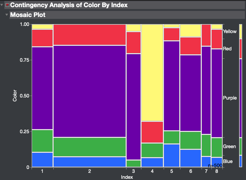

Thanks! That works well at putting the number in the chart itself (example below). Is there a way to put it below the chart area?
It would seem that it is the bottom right of LineupBox (or AxisBox), but I can't get your approach to work with those. Suggestions?
