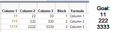

What's the right way to reference a column by index? Ideally I was looking for something like this:
Thank you in advance!

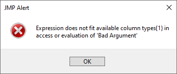

It may be true for scripts, but in formulas I get this error:

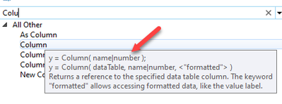

Interestingly, the popup suggests thatthe number can be provided, but it doesn't appear to be the case

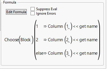

Try with << get name instead of Column Name()
Choose(:Block,
	Column(1) << get name,
	Column(2) << get name,
	Column(3) << get name

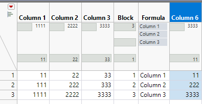

Thank you jthi, I feel like "<< get name" gets us one step forward. My final goal is to do a HLOOKUP basically, here's a demonstration. Currently it pulls the column name, while I want it to look at the data of that column.

Re: Column by index
Ah... I see what you want now.
Try this as your formula. It uses the format column(dt, n)[row()] to get the value in the current row, of the nth column of a data table, where the value of n is whatever you've placed in the current row of the :block column.
Column( :Block << get data table, :Block )[Row()]
Cheers,
Brady
IvanK
Level II
Re: Column by index
Thank you Brady, this is exactly what I was looking for. Much obliged!
