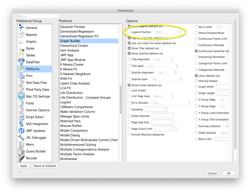

@julian, Is there a way change the default position of legend?
julian
Re: Change the Legend Location in Graph Builder
Hi @Rajat,
Absolutely! The place to find all the platform preferences is by going to File > Preferences. Next, select the Platforms group on the left, then select Graph Builder. Finally,check the box to specify the location for the legend by default. If you find that you're changing something in a platform regularly it's worth setting a preference for it.
I hope this helps!
@julian
