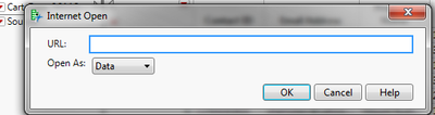

That brings you to this pop-up window which ask you for the URL. Copy and paste it there and select the Open As: Webage, Data and Text.

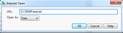

Let's be a little adventurous shall we?  What do you think will happen when you put a file path location into a web browser?  It opens it!
Let's try the same here.
Example:
It works!

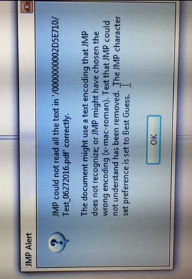

I already tried to put path name as : c:\temp\my_test_file.pdf
I got the message below.
Re: Can JMP read PDF file/s?
Did you attempt uploading the file from your local computer using the internet connectivity data upload file above? If you are uploading directly from your computer instead of the internet, you don't need the link, but rather use the File > Open option
