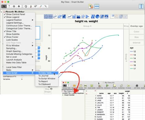

When you chose Scripts->Save Script to Data Table... from any red triangle JMP will save a script to the scripts area of the data table.
Save Script to Data TableSave Script to Data Table
When you save the data table that script should be saved with the data table and when you open it again you can run it by clicking the green triangle next to the script name. Is there some part of this process that is not working for you?

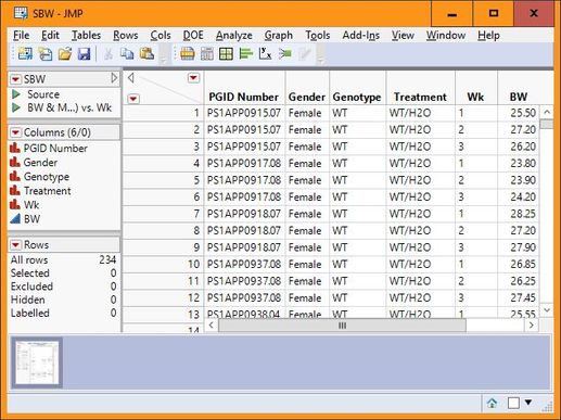

Here's one of these cases. I've created a table with all the data I need to create a graph (or to do some an alysis). I've used Graph Builder to create the graph and chose "Save Script / To Data Table" - and there it is below the data table:
Now I save the data table to SBW.jmp - done.
After some time I learn that some of the data needs to be corrected, so I reopen the data table, and the graph is gone - bummer.
Now, we're getting somewhere. Thanks for posting the screen shot. That and your comment "there it is below the data table" now explains the confusion.
The thumbnails below the data table show the reports windows that are based on that data table. They are not part of the data table. They don't have anything to do with saving scripts to the data table – they show up with every report window you open on that data table, whether you save a script to the data table or not. And, as you've discovered, they aren't saved with the data table.
From what I learned from you, the script is actually there (having a green triangle), but not where I had expected it. Maybe subheadings "Graphs", "Analyses", ... separating the green triangles would help?
