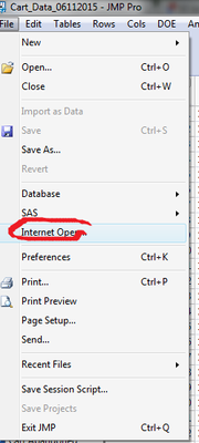

Yes, If you just want to view a pdf in JMP. Yes, JMP has the capability to upload the file and view it. If you have a pdf file with data that you need to extract, than you might want to use the Internet Option by clicking on File > Internet option and select it either as a web page or text.
That brings you to this pop-up window which ask you for the URL. Copy and paste it there and select the Open As: Webage, Data and Text.

Did you attempt uploading the file from your local computer using the internet connectivity data upload file above? If you are uploading directly from your computer instead of the internet, you don't need the link, but rather use the File > Open option
