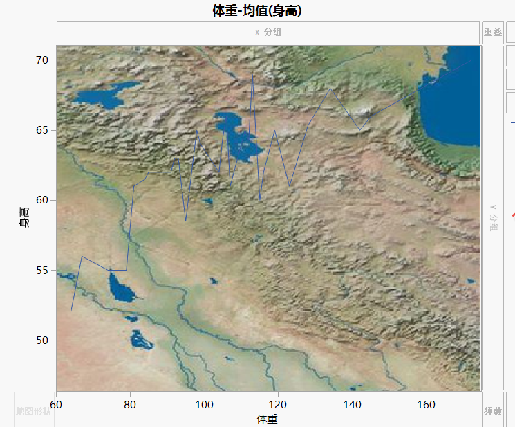

Can I add a custom image as background in JMP graphics?
I don't think this is it?
Thanks!
dt=Open("$SAMPLE_DATA/Big Class.jmp");
p1=dt<< Graph Builder(
	Variables( X( :weight ), Y( :height ) ),
	Elements( Line( X, Y, Legend( 5 ) ) )

Graph Builder(
	Elements( Line( X, Y, Legend( 5 ) ) ),
	SendToReport(
		Dispatch( {}, "height", ScaleBox, {Scale( "Geodesic" ), Minor Ticks( 0 )} ),
		Dispatch(
			"Graph Builder",
			FrameBox,
			{Background Map( Boundaries( "World" ) )}
chang
//{Background Map( Boundaries( "World" ) )}
{Background Map( Boundaries( "I:\00\18\Samples\Images\tile.jpg ) )}//?

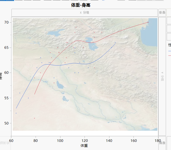

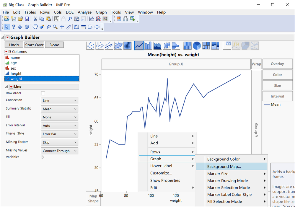

jthi
Re: Can I add a custom image as background in JMP graphics?
lala
Level IX
Thank jthi !
