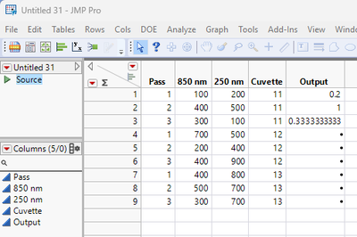

Hey, I'm new to JMP scripting, but somewhat used to python language. I'm trying to achieve the following with my dummy test table below:
1) Cycle through all rows (both before and after the row) and do calculations only on those rows where Cuvette == 11, remaining rows where Cuvette != 11 the "Output" can be set to NA or whatever.
2) The calcuation itself is between two separate rows. In rows with Cuvette == 11, the 850 nm cell of the row has to be divided with the 250 nm cell from the row that meets two conditions:
                   a) Cuvette == 12
                   b) The Pass value has to match up between the rows, e.g. Pass value for cuvette 11 == Pass value for Cuvette 12
Pass 850 nm 250 nm Cuvette Output
1 100 200 11 100/500 = 0,2
2 400 500 11 400/400 = 1
3 300 100 11 300 / 900 = 0.33
1 700 500 12 NA
2 200 400 12 NA
3 400 900 12 NA
1 400 800 13 NA
2 500 700 13 NA
3 300 700 13 NA
