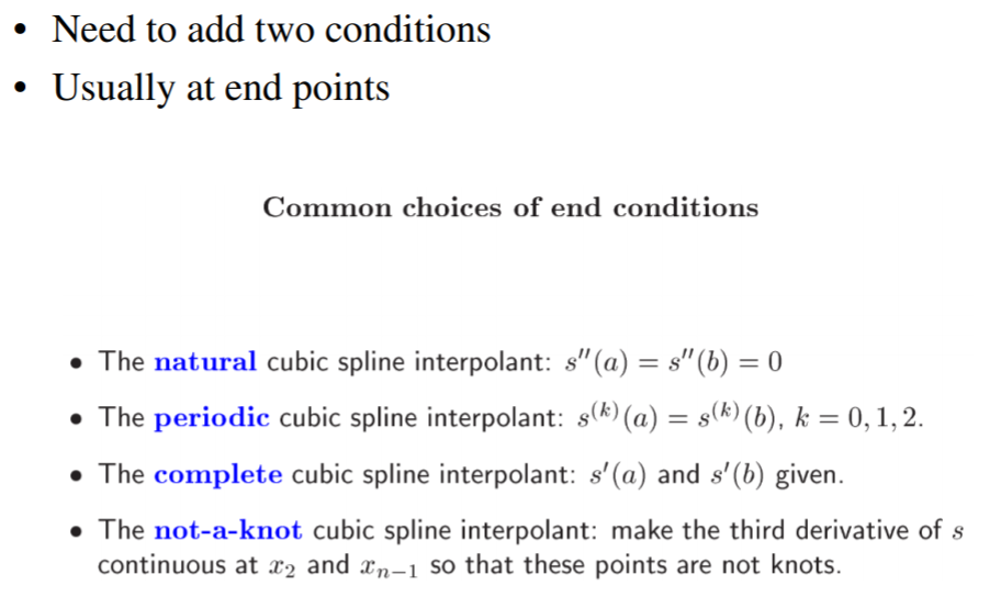

http://users.umiacs.umd.edu/~ramani/cmsc460/Lecture9_interp_2008.pdf says
snip of a pdf describing how to choose slope for first and last end points of a splinesnip of a pdf describing how to choose slope for first and last end points of a spline
I suspect 1 or 4 might apply here; I'm beyond my knowledge.

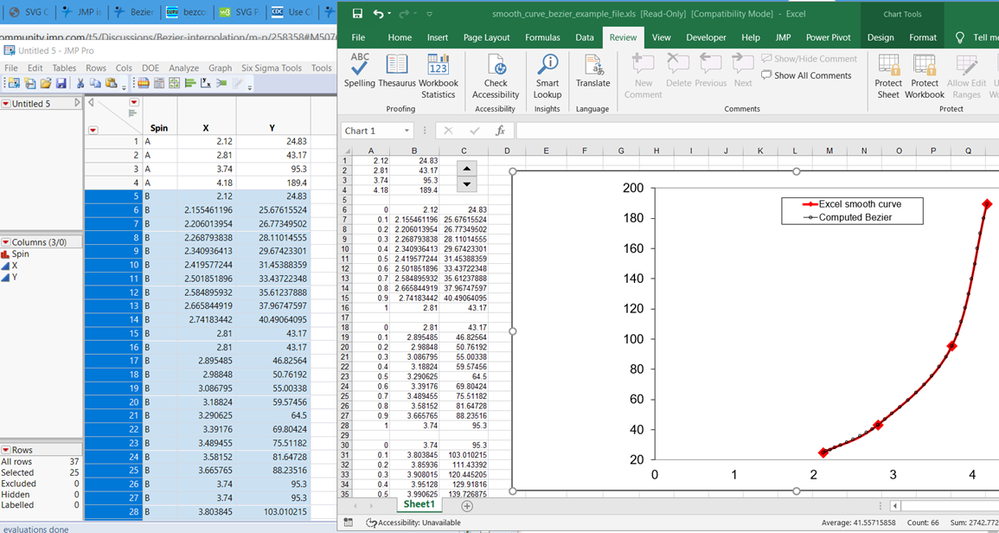

My knowledge and experience of Bezier curves is limited. I have seen their utility in drafting (construction and landscaping) design and clothing design. Of course, mathematical underpinnings always is interesting to me.  I did a little noodling around the internet and found that @mitulshah's quest for Excel's Bezier spline, B-spline, algorithm is a common one. One link Excel Smoothing Algorithm question included the link to a zip file: http://xlrotor.com/Smooth_curve_bezier_example_file.zip   This zip contains a 2002 .xls example of a Bezier curve with embedded   automation routines to grab the pixels from the Excel smoothed curve and interpolate teh points on the curve.  It is not "exact" and uses a technique that grabs 4 pixels off the curve. The endpoint is used twice in the first interpolated point and the last interpolated point.

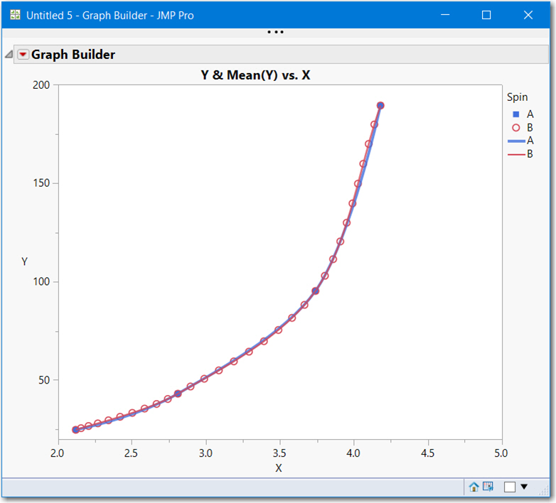

One JMP discovery I made after Craige's post about the GraphBuilder Line element option to make it a curve, is the spline used for this platform must use a different algorithm because the endpoint slopes are very similar to Excel's. i started a script to do some DSP (digital signal processing)  by extracting the pixels of the GB plot. Then I found the web links listed above, and decides to just use the interpolated points from the Excel spreadsheet and overlay it with the GB Line(curve). The first screenshot below depicts the Excel worksheet with the Excel graph with Bezier spline and interpolated points, which were added as Spin B points to the JMP table.  The second picture shows the JMP GB Line(curve) with the Excel interpolated points overlaid.
Excel Interpolated Points > Spin B in JMP tableExcel Interpolated Points > Spin B in JMP table
JMP Line(curve) spline overlaid with Excel interpolationsJMP Line(curve) spline overlaid with Excel interpolations
You'll notice the interpolations are slightly offset from the JMP Line(curve) on the upper tail, that could be due to the interpolation algorithm, differences in Excel and JMP curves or a combination of both. Note in those same 4 points are slightly higher than the the curve in the Excel chart.
So, my conclusion is that the JMP GB Line(curve) spline is very similar to the Excel Bezier curve.  My interest is not high, but if I get bored I might finish my DSP script to "get" the Line(curve) points.  Earlier versions of JMP used to report curve points in saved .jrn files,now just a reference to a hidden function is in the .jrn file.
