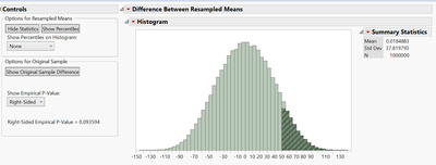

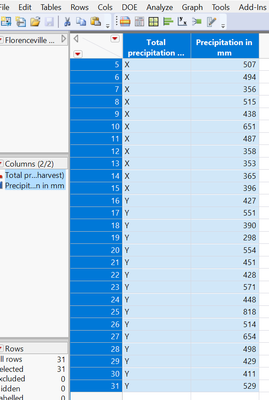

I run this data using JMP after representing previous 15 years by X and last 16 years by Y. see below.
I performed permutation test. See below:
Results show that 91 per cent time I could say that the precipitation increased in the last 16 years (2004 to 2020) than previous 15 years (1989 to 2003).
