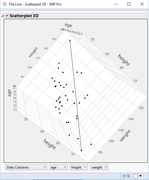

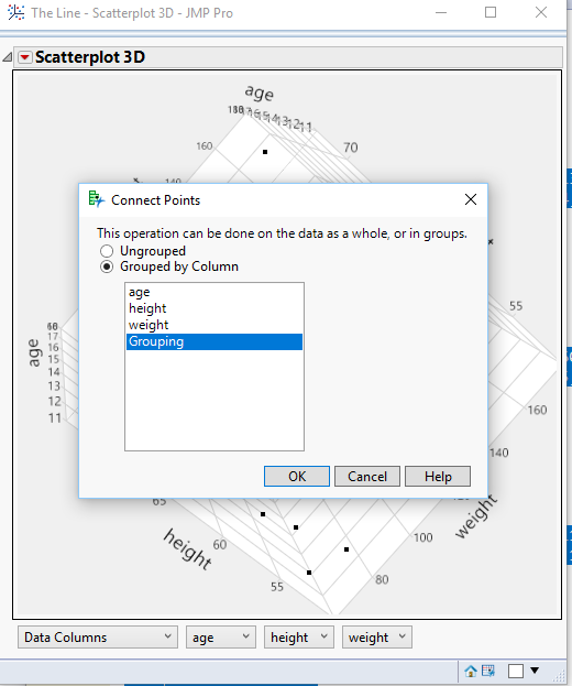

There really haven't been any JSL upgrades to the 3D Scatterplot Platform, however, I believe the following technique will work, and I believe that it actually was available in 2014.  What I do to create the following display
is to create a new column that only has a value for the 2 rows that I want to draw a line between, and then I use
the Connect Points,  grouped by the new column, and it draws a line just between those 2 points.  Below is a sample script

dt << Scatterplot 3D(
	Y( :age, :height, :weight ),
	Connect Points( 1, :Grouping ),

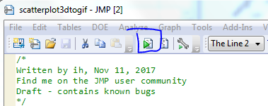

  1. Download and save the attached jsl script
  2. Create the scatterplot, add lines, resize, change colors, etc.
  3. Go to the red triangle in Scatterplot 3D and select save script > save script to clipboard.
  5. Open the jsl script you downloaded from here, at the top click run (make sure nothing is selected).
  7. Fill in the options on the left, I recommend starting with the defaults except to choose a filename.
  8. Paste your script from the clipboard into the text box on the right.
  10. Click go
Wait a few seconds or minutes depending on the size of the scatterplot, the amount of data, and the duration/frames per second you selected and eventually it should save a copy of your spinning 3D scatterplot.  To change which variable is on top, change the order of the data columns on the bottom of the scatterplot 3D platform before saving the script to the clipboard.
