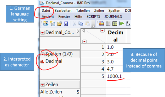

If the language setting aligns with the decimal format (US with decimals, GER with comma, …) the data will be imported and displayed correct as continuous and like in the source table. If the language setting differs, e.g. US number format in the spreadsheet and GER setting in JMP and/or the system, you will recognize that the data type changes from continuous to nominal character.
Usually you would use Column Info and change the Data Type from character to numeric and Modeling Type from nominal to continuous. In this case this will result in empty data as the Language setting cannot interpret the comma or the decimal, depending on the language.

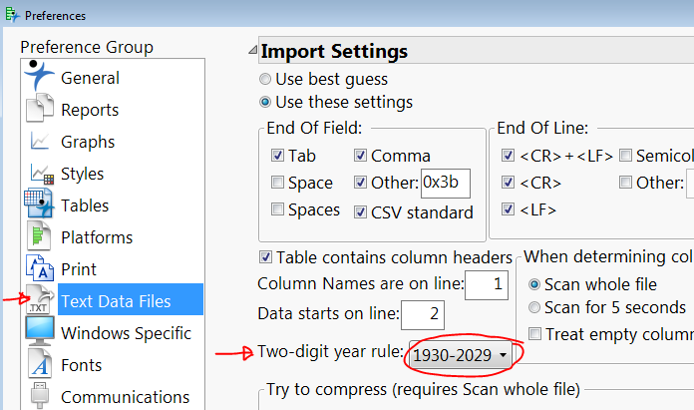

In case of two-digit year numbers you should take care that JMP recognize the correct 100 years. To do so there is a setting for the underlying two-digit year rule JMP should refer to:
  • Under File à Preferences select “Text Data Files”
  • Changing the Two-digit year rule will have impact on your date interpretation
  • Select the 100-year range in wich your dates fall.
  • For example, if the earliest date is 2/2/79, and the year is 1979, select 1970-2069. If the earliest date is 2/2/12, and the year is 2012, select 2000-2099 and not 1910-2009.
  • If dates span centuries, you must recode the dates with four-digit years before importing the data!
