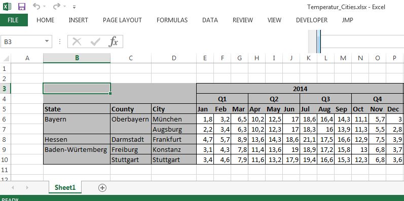

However not always you have variable names in the first row and the data beyond. Some structures in Excel files are good to gain an overview of the data in a table. At the same time those structure is often very cumbersome for the purpose of statistical analysis. So, how on earth do I get these kind of non-trivial spreadsheet data into JMP? Time for a first example:
Here you have data quite typical for Excel spreadsheets: hierarchical headers on top and at the side, some merged cells and the data in the spanned matrix. As you know JMP the data table could not be used for statistical analysis if you’d copy it just as it is. Therefore let’s open it using JMP’s Excel Import Wizard:

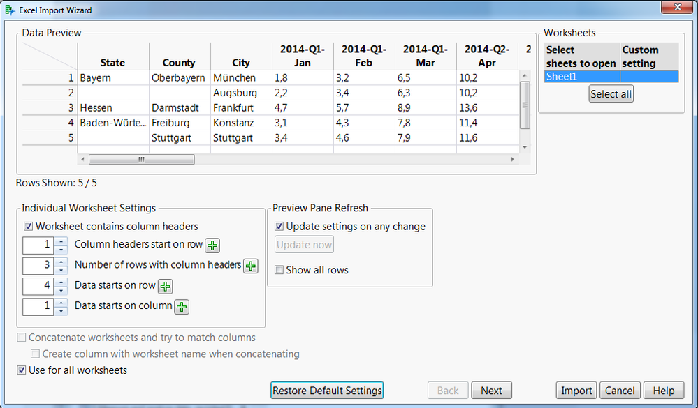

There are different options, and the most important one for this type of data you’ll find on both this page and the next of the Import Wizard. First you have to define the “Number of rows with column headers” with 3, as you have the year, the quarters and the months each in a separate row. This will combine the header information in one single header per column:

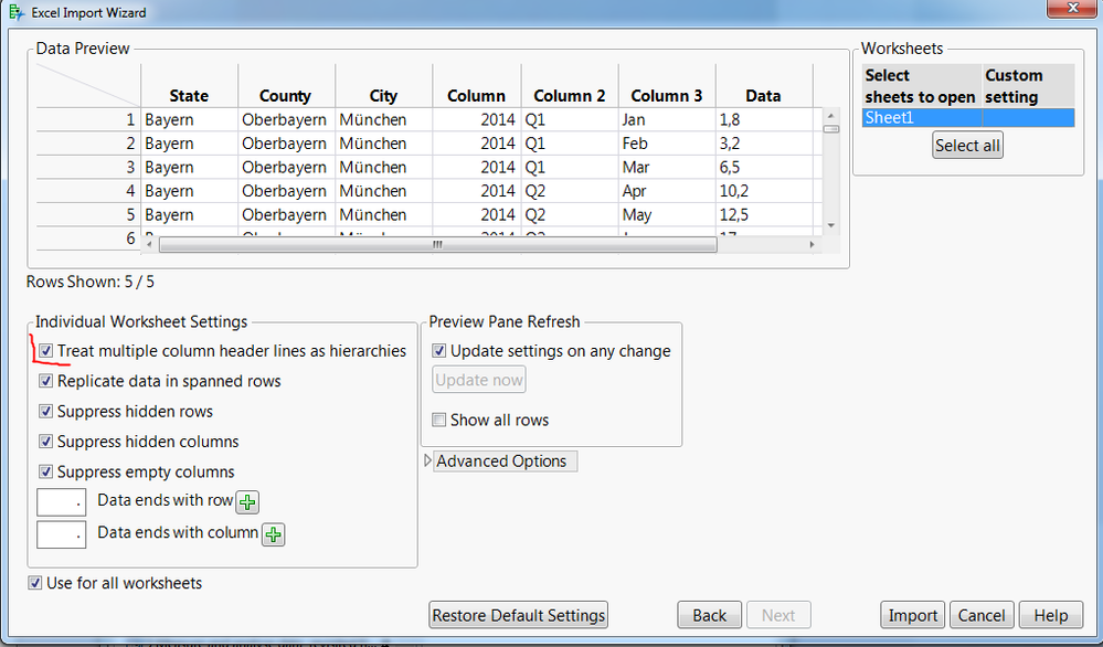

Now going to the next page we want to handle the information at the left, the states, counties, and cities. Checking “Treat multiple column header lines as hierarchies” will stack the header information into 3 new columns, providing a better structure for analysis. Now you are ready to import the data and analyze it.
