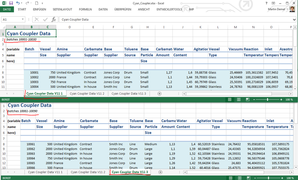

So let’s look at the data in Excel first:
 One can see the different workbooks, all having the same shape and non-trivial structure. Underlined in red one can see the different batch numbers on each workbook. I want to read in the data but not in separate tables. Rather I would like to have one single table and using JMP’s Excel Import Wizard this is quite easy to achieve:

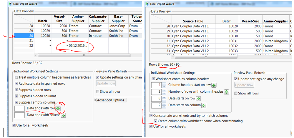

      1.  Drag the Excel Sheet into any JMP Window will open the Excel Import Wizard:JMPExcel_example2_2.png
      2. Make changes to the settings for the header and data fields where appropriate. We have a header we don’t want to include in the data, and the actual header starts in line 4 and spans over three rows. Then there is a row with empty fields. Therefore we start the data one line later (8 instead of 7). The first column does not have data for the analysis, that’s why we skip it.
      3. Clicking "Next" button we can make use of Last row setting, telling that we do not want to include the time stamp information. Selecting the row where the data ends and pressing the plus (+) sign you do not have to care about what line number is the correct one.
      4. The remaining thing is to make use of the same structure within all the worksheets. We can check the “Use for all worksheets” as well the “Concatenate worksheets and try to match columns” marker. This will change the preview from 30/30 rows to 90/90 rows. Considering that each of the three worksheets provide 30 rows this seems to work as expected. When you concatenate, it is strongly recommended to check also the “Create column with worksheet name when concatenating” flag. Otherwise it will be hard to reflect later where the data came from.
      5. Last step is to import and of course always check the imported data
