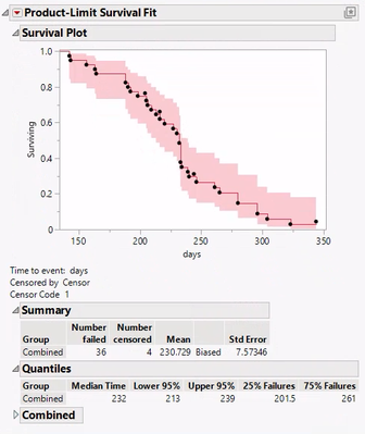

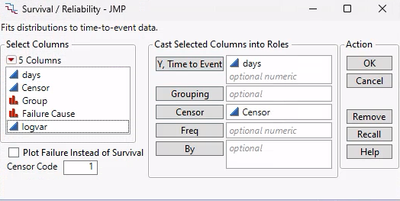

  1. From an open JMP® data table, select Analyze > Reliability and Survival > Survival.
  2. Select a continuous time variable from Select Columns, then click Y, Time to Event.
  3. If there is censoring in the data, add the variable identifying which values are censored to the Censor role. Click OK.
Report shows a survival plot and survival estimates including the average days to survive; the 25th, 50th (Median), 75% quantile; and a table displaying the percent survived, failed, number failed, and number at risk at each time value where the event occurred. The full Kaplan-Meier estimates are found in the Combined table. Options are available to enhance the Surival Plot under the red triangle. Here we added Shaded Pointwise Confidence Intervals.

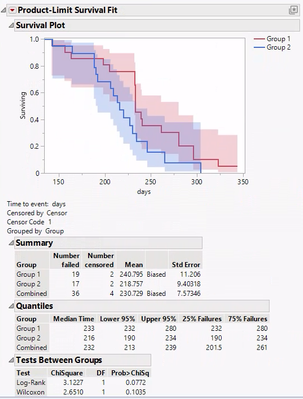

  4. Add the variable identifying the groups to the Grouping role. Click OK.
Report shows overlaid survival plots and survival estimates for each group, along with statistical tests testing the hypothesis that the survival rates are different between the groups.
