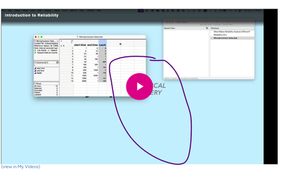

Hi, thank you very much for this introductory learning video—it's clear, practical, and engaging.
Unfortunately, the “View in My Videos” link doesn’t seem to be working properly. I’d really appreciate access to your additional videos, as I’d like to continue learning from this series.
