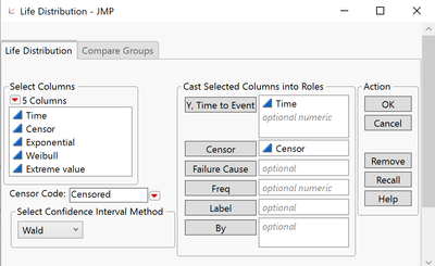

  1. From an open JMP® data table, select Analyze > Reliability and Survival > Life Distribution.
  2. Select a continuous time variable from Select Columns, then click Y, Time to Event (continuous variables have blue triangles).
  3. If the data contain censored values, select the censoring variable and click Censor. Change the Censor Code if needed (the default is Censored).
  4. Select the Confidence Interval Method (the default is Wald), and click OK. JMP will display:

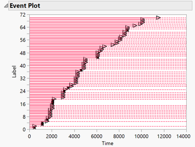

  • An Event Plot (click on the gray icon to open), which graphically depicts failures (denoted by X’s) and censored events (denoted by triangles).

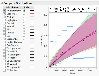

 To Compare Distributions:
  • Click a radio button under Scale to apply the scale for a distribution. If the selected distribution fits the data well, the plotted points will approximate a straight line.
  • Check a box under Compare Distributions to fit a distribution and display a fitted line, shaded confidence bands and a Profiler for the distribution.
  • Select Fit All Distribution or Fit All Non-negative under the top red triangle to compare all distributions using model comparison criteria such as AIC and BIC.
