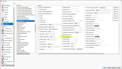

Q: Are there any Map Preferences I can set:
A: Yes, they are under File>Preferences>Platforms>Graph Builder. The Missing Shapes preference assures missing shapes show up.  Or, you can show missing shapes interactively for the map you are using in Graph Builder.
Missing Shapes PreferenceMissing Shapes PreferenceMissing Shapes Preference

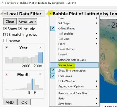

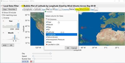

Q: How are bubble sizes determined and can I change them?
A: Bubble size is relative based on the variable (Column) that you want to show.  To see what you have chosen, from Bubble Plot red triangles select Show Roles. Change the analysis if you want to plot bubbles for a different variable.
Bubble Plot Show Roles Option from Red TriangleBubble Plot Show Roles Option from Red TriangleBubble Plot Show Roles Option from Red Triangle
Exxamine Variable Determining Bubble SizeExxamine Variable Determining Bubble SizeExxamine Variable Determining Bubble Size
