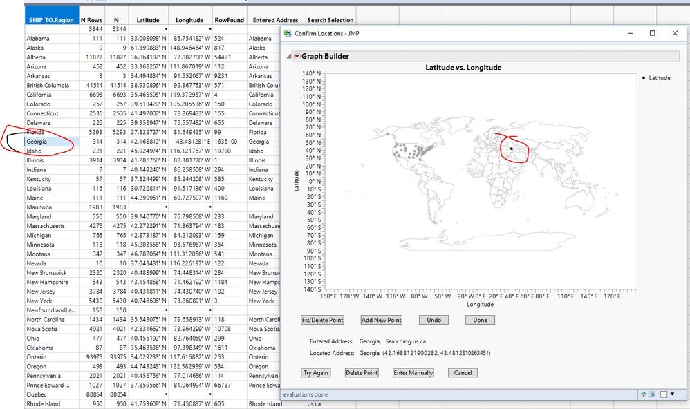

Hello,
Is anyone else having an issue with Georgia?  It found the country not the state.  I'm especially surprised because I set the search to custom and selected just USA and Canada.
