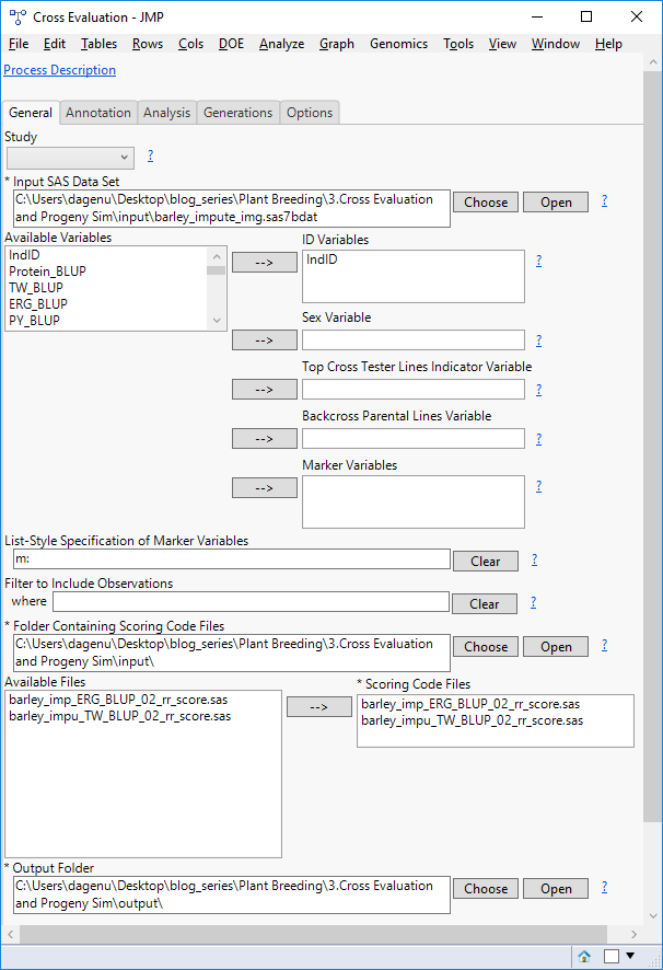

  1. From the Genomics Starter, select Genetics > Breeding Analysis > Cross Evaluation to bring up the dialogue box.
  2. In the General tab, select barley_impute_imgsas7bdat as the Input SAS Data Set.
    • The data set contains markers for each line and 4 quantitative traits, 2 of which we will be selecting for.1_input_table.png
  3. Select both IndID as the ID Variable.
  4. Leave the Sex Variable
    • Note that values for the Sex Variable must be either “1” and “2” or character strings starting with “M” and “F”.
    • Also, note that when a sex variable is specified, no self-crossing can be included in the analysis.
  5. In the List-Style Specification of Marker Variables box, type m: to specify all columns beginning with the letter “m” as marker variables.
  6. Navigate to the Folder Containing Scoring Code Files and designate it as such. This will populate the Available Files box with your Scoring Code Files. Select from the list the files corresponding to the traits to analyze and move them to the Scoring Code Files
    • A scoring code file is a SAS program file containing a model which includes the effect of each marker on a trait of interest. The file can be previewed using a text viewer.
    • Anywhere from one to four of the phenotypes in this data set can be selected for by simply including or excluding the scoring code files for the desired phenotypes. Here, we will select for Ergosterol Content (ERG) and Test Weight (TW).2_scoring_code.png

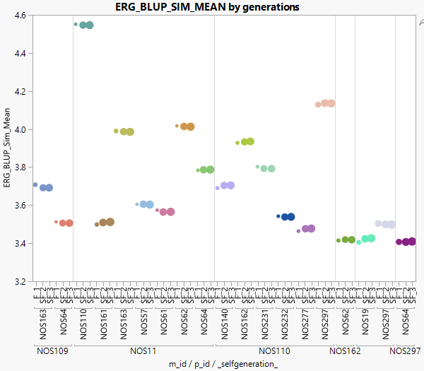

  4. The Simulated Trait Means tab gives the mean of all simulations for each generation of each trait. The size of the points represents the standard deviation of the population.
    • Judging by the trait means, there was not much improvement in the ERG BLUP mean through the first 3 generations.13_traitmeans_3gen.png
