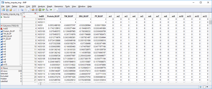

  2. In the General tab, select barley_impute_imgsas7bdat as the Input SAS Data Set.
    • The data set contains markers for each line and 4 quantitative traits, 2 of which we will be selecting for.1_input_table.png

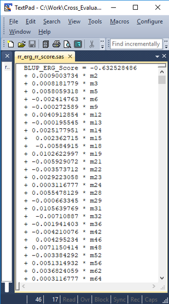

  6. Navigate to the Folder Containing Scoring Code Files and designate it as such. This will populate the Available Files box with your Scoring Code Files. Select from the list the files corresponding to the traits to analyze and move them to the Scoring Code Files
    • A scoring code file is a SAS program file containing a model which includes the effect of each marker on a trait of interest. The file can be previewed using a text viewer.
    • Anywhere from one to four of the phenotypes in this data set can be selected for by simply including or excluding the scoring code files for the desired phenotypes. Here, we will select for Ergosterol Content (ERG) and Test Weight (TW).2_scoring_code.png

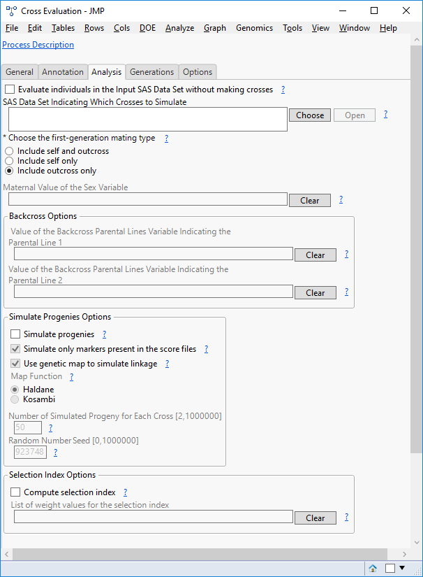

  9. In the Analysis tab, an option is available to specify a SAS Data Set Indicating Which Crosses to Simulate. If left blank (as in this example), JMP will simulate all possible crosses.
  10. When a Sex Variable is present and the Maternal Value of the Sex Variable is left blank, JMP will designate either “1” or “F” as the maternal sex variable as a default.
  11. Select Include outcross only for the Choose the first-generation mating type
  12. Options for backcrossing (when a backcross parental line variable is specified), progeny simulation using genetic mapping (when an annotation file is present), and including a selection index (a weighted value of the effect of each trait) are also available on the Analysis. Leave these blank for this example.4_analysis.png

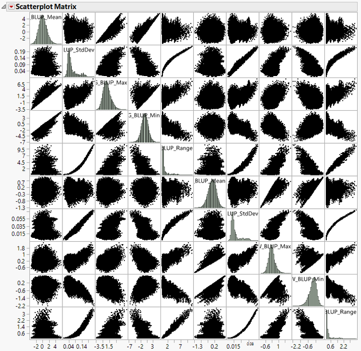

  1. When the analysis is finished, a results window will appear with a scatterplot matrix showing correlations of the mean, standard deviation, max, min, and range of every simulated cross. Each of the paternal and maternal individuals are listed to the left of the matrix with the number of simulated crosses that they were involved in given in parentheses. Selecting any of the individuals will select all its crosses in the scatterplot matrix.5_scatterplot_matrix.png

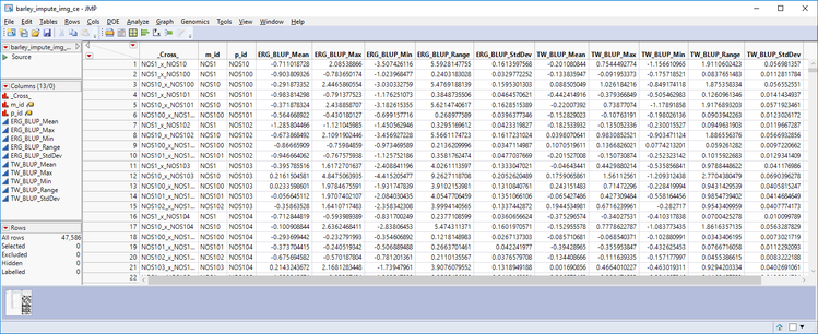

  2. Clicking View Data on the far left opens a new data set with each of the 47,586 simulated crosses and their phenotypic estimates. Selecting any point in the scatterplot matrix or any individuals from the maternal/paternal ID lists will also select those crosses in the data set.6_cross_dataset.png

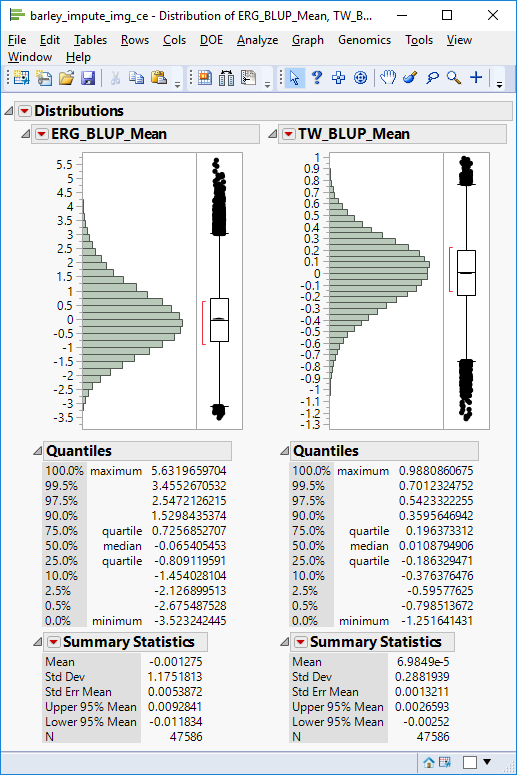

  2. Before making selections for progeny simulation. Click View Data under the Drill Downs menu and look at the distributions of the two traits by selecting Analyze > Distribution.
    • Select BLUP_ERG_Mean and BLUP_TW_Mean and move them into the Y, Columns. Then click OK.
    • From the distribution tab, percentiles of each trait’s distribution are easily seen. Using the percentiles from the phenotypic distributions, return to the results window and the Data Filter.
    • Data filters can be applied to the first generation progeny under the Data Filter. Filtering criteria for each trait can be selected by adjusting the sliders under the trait of interest or clicking the numbers next to each trait and typing the desired cutoff.

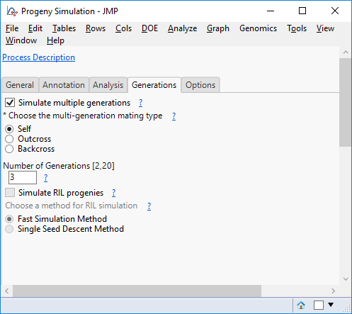

  8. On the Generations tab, select Simulate multiple generations and select Self as the option for Choose the multi-generation mating type.
  9. Set the Number of Generations option to 3 to simulate 3 generations of selfing from our selected crosses and click Run to begin the analysis.10_PS_Generations_tab.png

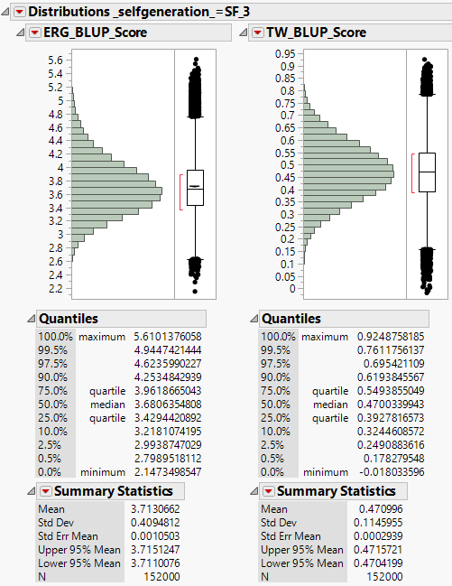

  1. When the analysis is finished, a results window will appear with the Simulated Trait Distribution tab showing distributions of each of the simulated trait measurements for each of the three simulated generations. Generation 3 is shown below.11_simmed_dist.png
    • Scroll to the right to move through the generations note that each generation has 20x more observations than the generation preceding it.
    • Scroll down to see scatterplot matrices showing the correlations of the traits for each generation.
    • Note that selecting any points on the histograms or scatterplots will select those points on every plot for the corresponding generation. Individuals can also be selected in the Data Filter section to show their performance in each of the plots.

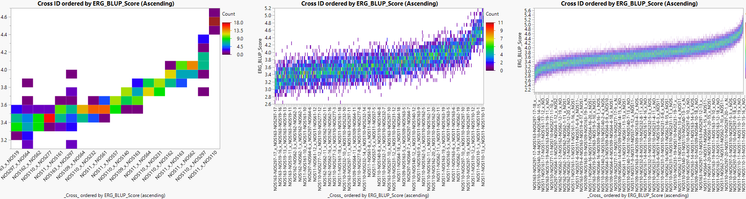

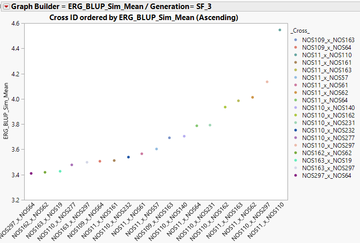

  2. The Simulated Trait Ordered tab gives heatmaps for each simulated generation of the traits ordering crosses on the x-axis by their performance. The three generations of ergosterol content (ERG) performance are shown below.12_heatmaps.png
