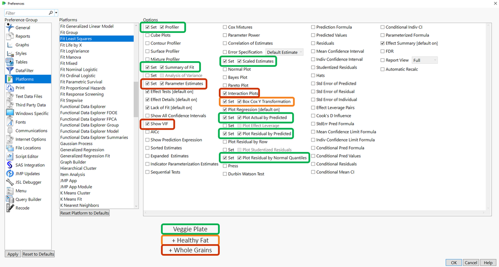

JMP’s developers set up default reports in Standard Least Squares based on the data. Think of the Emphasis that is chosen as the template of outputs shown. The outputs that are shown and expanded are a great place to start, but if you want to use the menu framework I have proposed in this series, you will need to do some customization of your Preferences to ensure the “menu” outputs always show up as a default.
To set your model preferences, go to File > Preferences and navigate to the Preference Group “Platforms” and select “Fit Least Squares.”
Here, you can check off your favorite graphs/tables/statistics so that they will always pop up (Figure 2). This is “meal planning” for the motivated analyst who has a new year’s resolution to conquer! :flexed_biceps:
Figure 2: Fit Least Squares output preferences. The non-default outputs are highlighted here with colored boxes and correspond to the outputs in the menu framework in Figure 1.Figure 2: Fit Least Squares output preferences. The non-default outputs are highlighted here with colored boxes and correspond to the outputs in the menu framework in Figure 1.
