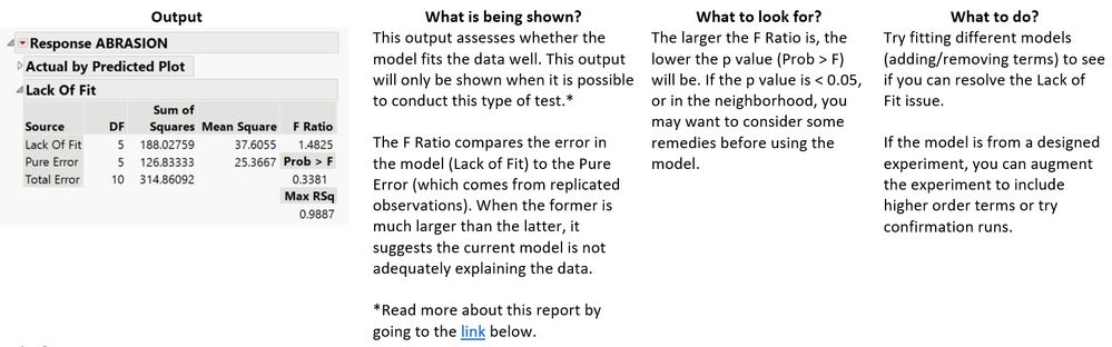

Lack of Fit
*Lack of Fit

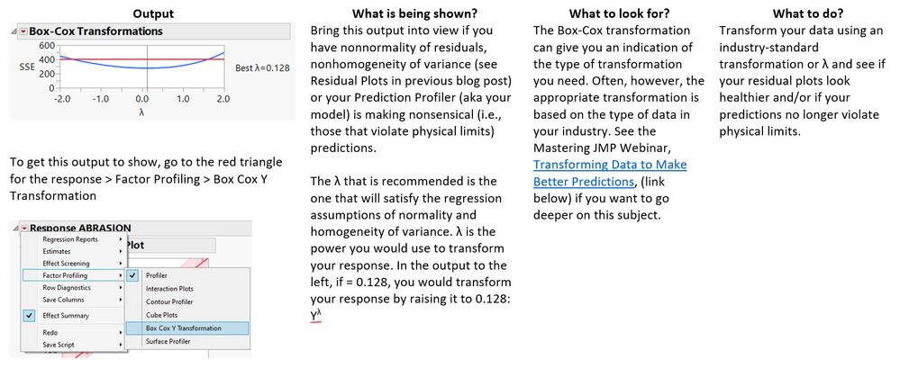

Box-Cox Transformation
Transforming Data to Make Better Predictions

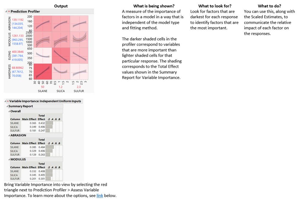

Variable Importance
Assess Variable Importance

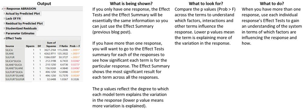

Effect Tests
