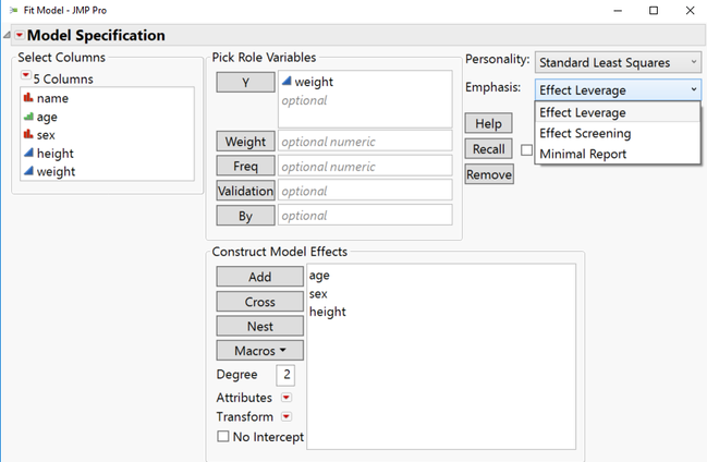

For those already using JMP: Have you ever noticed the Emphasis in the Fit Model input dialog and wondered what it is? I know I was pretty confused about it for a while. In contrast to the Personality options right above it, Emphasis does not change the type of analysis that is done. The different options simply turn on different model outputs as a default when you click Run. JMP uses the amount of data (number of rows) you have in combination with the number of model terms you want to estimate (number of terms in the Model Effects dialogue) to determine the best set of outputs to show you by setting a default Emphasis (Figure 1). JMP is always guiding analysts toward the best path, and the Emphasis selected is no exception. JMP uses the contents of your data to set the default Emphasis. (For more specifics on how it does this, you can read the documentation.)
Figure 1: Standard Least Squares Emphasis. JMP sets a default Emphasis based on your data, but you can change it. Emphasis determines the set of outputs that are shown; it does not affect the statistical analysis.Figure 1: Standard Least Squares Emphasis. JMP sets a default Emphasis based on your data, but you can change it. Emphasis determines the set of outputs that are shown; it does not affect the statistical analysis.
