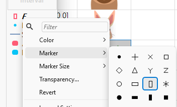

1) manually assign a marker via the legend in Graph Builder:

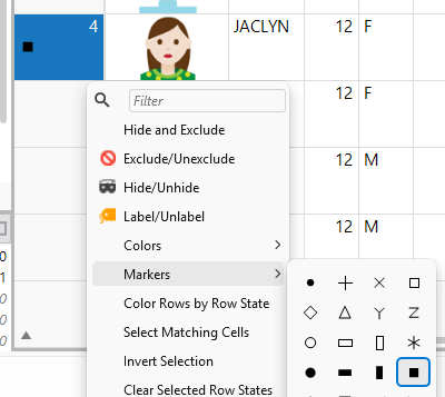

2) Row States: this settings allows the user to override the marker setting for specific rows:
On the other hand, this setting is overruled by marker settings via the legend.

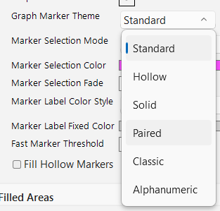

Actually there is a 3rd option to tune the marker settings: via preferences, one can choose a default marker setting

1) if the user accidentally selects a legend entry before assigning a new marker state, the new marker will be assigned to all selected entries:
So, if you assigned the new marker to 73 entries in the legend, be sure that you don't select an entry when assigning the marker to entry & # 74, 75 !!!)

Elements( Position( 1, 1 ), Points( X, Y, Color( 1 ), Marker Graph Theme("Hollow") ) )
to pick a specific marker set for a plot.
