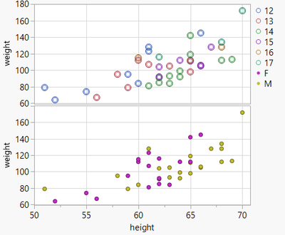

I have encountered an issue in JMP when plotting multiple levels of information in one plot.
For example, the colour in the top graph is defined by age, while the colour in the bottom graph is defined by sex.
By default, JMP uses the same marker type for all plots.
This makes it difficult for the human eye to interpret the information in the legend and in the plot ('Is the purple dot 15 or F?'); even the human brain needs time to process the information.
"I am in the upper plot - with ages. I can ignore the F & M and focus on the numbers in the legend. Purple corresponds to "age=15".

NB:
This example was chosen to highlight the problem.
Clearly, for this example, more meaningful settings would be to have just one plot and sex = marker | age= color
... which is not possible for the real, more complex application case.

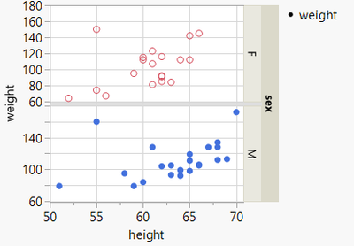

Hi @Stuart_Little , thanks for your suggestion.
Unfortunately, your script produces this graph:
This is not the graph which is needed.
The task:
Specify a marker type for a plot (i.e. all the data points in that plot) -- without affecting any other plot.
Row states are ideal for:
Specify a marker type for some data points - simultaneously for every plot.
Is there a trick how I can use Marker States for my purpose?
