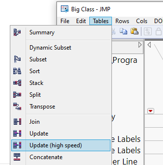

One could replace the Tables/Update platform with a user-defined one.
  • it sets Add/Replace Columns to Selected/None (instead of All/All) -->  less columns are evaluated for the preview
  • a user defined Button OK (high-speed) can trigger Tables/Join after converting the settings
    via UpdateHS()
Names Default to Here(1);
dt = Current Data Table();
If(isempty(dt) | N rows(dt )==0, stop());
Try( myDTUpdate << close window() );
myDTUpdate = New Window( "Update - high speed", dt << update() );
myDTUpdate[Lineup Box( 1 )] << Prepend( mb = MouseBox( Button Box( "OK (HS)", updateHS() ) ) );
mb << settooltip( "high speed via Tables/join" );
//DtUpdateHS:myDTUpdate["Preview", CheckboxBox( 1 )] << set( 1, 0 );
myDTUpdate["Add Columns from Update Table", Radio Box( 1 )] << set( 3 );
myDTUpdate["Replace Columns in Main Table", Radio Box( 1 )] << set( 2 );
