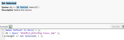

column<< set selected
add a link to
dt << Clear Column Selection();

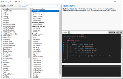

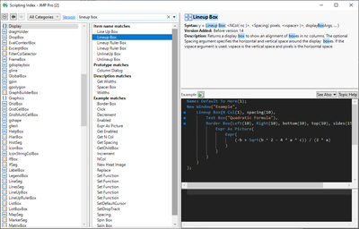

Lineup Box:
The "example" is definitely a nice application case for lineup boxes.
But: Is N=1 really the best possible example for N Cols Lineup Box?
Does it make sense to add a second (slightly more general) example?
jthi
N Col(1) is a good example, because it will make all displays have similar width BUT there should be first example with larger N Col and this N Col(1) is more like a special case (even though it is very common and usable case).
Also noticed that we have Line Up Box in Scripting Index which uses N Col(2) and then Lineup Box which uses N Col(1).

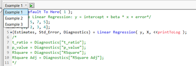

good examples:
For some commands, there are plenty of example codes listed, all the possible options are listed as comments in the examples and there are even some explanatory comments
-> very helpful  :)
