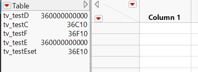

could someone help me understand why  the 36D10 and 36E10 table variables come back expanded to sci notation? but seemingly only for 'new' instead of 'set' table variable?
Thanks,
--Peach
dt = New Table("Table");
testvar = "36D10";
dt << New Table Variable("tv_testD", char(testvar));
testvar = "36C10";
dt << New Table Variable("tv_testC", testvar);
testvar = "36F10";
dt << New Table Variable("tv_testF", testvar);
testvar = "36E10";
dt << New Table Variable("tv_testE", testvar);
testvar = "36E10";
dt << Set Table Variable("tv_testEset", testvar);

E is for exponent and (a very long time ago) D for a double precision exponent.
I recommend using SETTableVariable; it behaves the way I'd expect: stores a number as a number and a string as a string and creates a table variable only if it isn't already there.
NEWTableVariable adds a suffix to the name if it already exists and, (the unexpected behavior), converts strings that look like numbers to numbers.
To further confuse things, dt<<GETTableVariable("name") returns a string, even if the value is numeric.
I recommend using dt:name to get the numeric value or the string value that is stored.

Thanks Craige, that helps clarify and establish how I should use.
Might be nice for something to be added to documentation, or perhaps the implementations of each changed in a future JMP version so they are consistent- it seems pretty hard for a user to know the differences in behavior with the current documentation (and the 'E' I immediately did think, 'oh it's doing something w/exponent - but the 'D' causing an issue really threw me for a loop).
