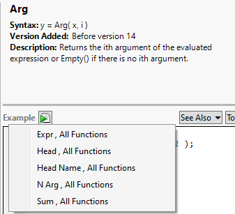

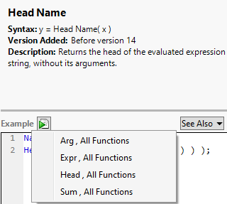

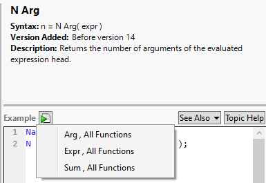

HeadHeadName are missing in  NArg
NArg is missing in Head and HeadName
