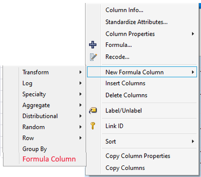

The New Formula column submenu in the column right click context menu is very useful to quickly generate new formula columns.
But: Often a user just wants to get a column with the values, without the need of a formula column.
compare the options of Recode:
What is the improvement you would like to see?
Please add an option to the New Formula right click context menu, allowing the user to toggle between
- Formula Column and
- New Column (just calculate).
A third option could be:
- Formula Column (1x) like it is implemented in the Normalize Function of the QuickSelect Toolbar  :
This way a Formula Column is added to the table, but the evaluation is disabled after a first calculation.
Why is this idea important?
With the additional option available, a user can generate "pre-calculated" columns as easy as he can generate formula culumns.
The third option would allow the user to generate a pre-calculated (non updating column) with the additional benefit that the calculation is stored/freezed - ideal for documentation, and with the possibility to reactivate it.

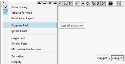

This option is "already offered" in Formula Editor. If you go to top right corner and select Suppress Eval:

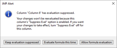

and then you press OK/Apply you are given these options:
Captured action seems to only have Suppress Eval
