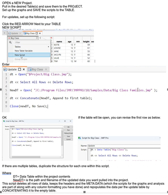

Often SCRIPTS for analysis (e.g. Graphs in a JMP Project) are often saved to the data table.  When you want to do the same analysis on a "refreshed" dataset you must use the same table or recreate all of that work.  There is a work around that a JMP Tech. Service individual provided.  The request is to make this functionality part of JMP rather than having to create another script.  Here are notes on the work around:
