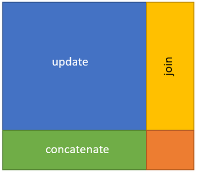

Open the new data table + "Table/Update" --> great for update and join - if no new rows were added.
For "concatenate", Martin wrote in his blog:
https://community.jmp.com/t5/Martin-Demel-s-Blog/Updating-a-JMP-data-table-from-a-spreadsheet-made-e...
the idea to read just the last N rows and concatenate with the existing table, which gives you access to the green and orange region.
A single additional button in the Update menu could do the universal job:"append additional rows"
... or for the case of "match columns" enabled: "append non-matched rows"
- if there are more rows in the update table than in the jmp table, they are added at the end of the table
- for "match tables": if there are non-matching rows in the update table, they are added at the end of the table
and if "add columns" is enabled in addition, data from the specified columns in the rectangle on the lower right will be added as well

With the additional cases
- rows in the update table were deleted
- the order of rows was changed
... a short manual procedure that can handle all "updates" except the yellow "join" area:
- delete all rows of the table
- run the scource script *)
- concatenate the original table and the newly loaded table.
This gives you the blue, green, red and orange region.
*) source script should include all manual changes to the table.

2 days later, new lots were measured (#3 & #4) and new columns were added (Lot_Wafer Label).
Now it would be great to get all the new data into the existing firstDataSet  keeping the JSL Scrips #1 - #3 and the radius column.
The idea: use the existing Update function, use Lot, wafer x_Die and Y_Die as Match columns
--> blue area gets updated (just imagine that there are some updates), and the green area (new Lot_Wafer Label column) gets added.
Now, the wish:
There are some non-used rows left in the input data table (green, orange block). Such rows could be added as well  - if "append non-matched rows" is enabled.
Without "append non-matched rows" in the update function (as it is now), the user has to first split the new input data into a part that can be used for the update and a second part which can be "concatenated".
