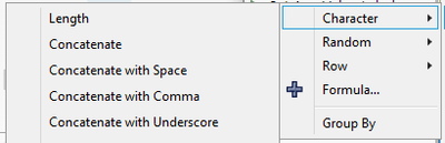

I have two columns of integers (along with a bunch of other columns), and would like to overlay in Graph Builder on the pairing of the two --
Since overlay only accepts a single variable, I typically do this by creating a new column with both columns comma-separated by using the "New Formula Column" -> "Character" -> "Concatenate with comma", but when both columns are numeric, concatenating with comma is no longer an option, requiring a custom formula with char() and "||".
Request adding a "Concatenate with comma" option to "New Formula Column" -> "Combine" menu.

I generated my own Add-In Toolbar item to solve the issue.
another workaround: add an empty "character" column and cocatenate the tree of them.
(As soon as there is one character column included, concatenate is available.)

the "low-prio half" of the topic (concatenate with comma, underscore ...) is already delivered for a while:
but the top-prio part (same functionality for numeric columns) is still pending :(
