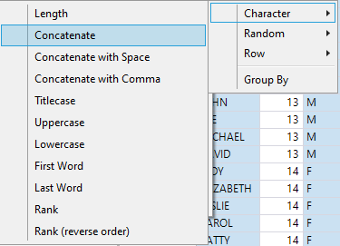

If columns with type "character" are selected, the New Formula Column menu shows the submenu character.
Among other option, there is the function concatenate which concatenates the strings.
There are also 2 more functions. They concatenate with Space or comma.
My wish:
  • A more general function "concatenate with string ...".
    The idea: After selecting this function, a window pops up and asks the user to enter a string.
    Then one can concatenate also with "_" or "-" or ...
Contrary to what I wrote in a previous version of this post, "concatenate" is also available if characters AND numbers are selected.
If numbers are selected as well, a char(number) is added automatically. Cool :)
Unfortunately, the character/concatenate function is missing if all the selected columns are numbers.
Could you please make the concatenate function available also for this variant?
